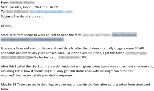

This is what i get back from my developers using the store card endpoint suggested. We've tried this earlier.
Once you have the card token from the Store Card workflow, you should use the Transaction endpoint to process a transaction against that card. At that point you are no longer using Blackbaud Checkout.
Let us know if that works.
Thanks.
We tried with Transaction endpoint as given in the documentation by passing token got from the store card call with test payment configuration id and got Error message saying invalid card token.
what value do we need to pass in the payment configuration id to make it work. right now I am passing id configured for test.
Here is my request data and the endpoint we are calling.
end point : payments/v1/transactions
"amount": 2500,
"card_token": "****46bg",// token got from store card call
"payment_configuration_id": "****4155"
Could you please let us know what is going wrong?0 -
