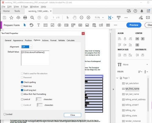

I know that this post is a somewhat older one, but I wanted to add to it, to let you know that you can use a few select S120 S-Tags in your custom PDF receipt.
When looking at this documentation atyou can name your field anything you like as long as it starts with “tpt_” and all spaces are underscores, e.g. “tpt_title” or “tpt_first_name”. Then, you need to double click on the field as you're preparing the PDF form in Adobe Reader Pro and go to the “Options” tab and then look for the field that is the “Default Value”. This is where the S120 S-Tag goes. Don't forget to go to the “Apprearance” tab and make sure that your font family and font size are matching the Word document that you used to create the PDF, so that it maintains a consistent look and feel.
Here is a screenshot of the “Options” tab while editing a field on a PDF receipt template:
“Options” tab while editing a PDF form using Adobe Acrobat Pro I hope you find this information helpful.
