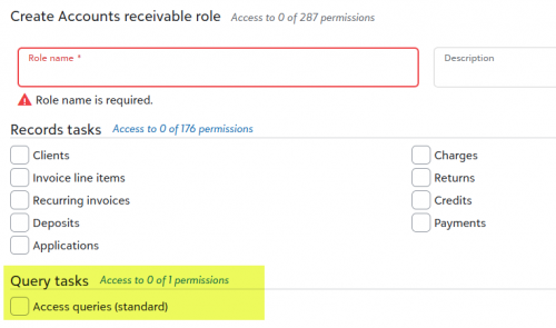

@Erik Leaver, here's what we see in our UAT environment:
And here's what we see in production:
The list of available roles is quite different. Is there something that we need to change at a higher level?
@Aaron Spike Images are broken :-(. I'd reach out to your implementation team and ask why the permissions are different between the two environments. I'd guess your user account doesn't have the same permissions enabled in prod that are currently enabled in test.
