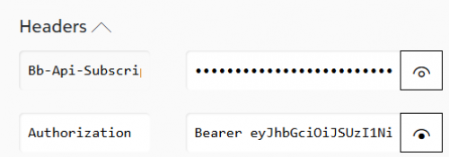

to make any SKY API calls, you need to provide in the HTTP Headers: Bb-Api-Subscription-Key and Authorization, where Authorization begins with Bearer follow by the authorization token.Your developer.blackbaud.com account will give you Subscription Key, Application ID (client_id) and Secret (client_secret). You are not going to get authorization token from developer.blackbaud.com

Regarding the application ID, we aren't building or registering an application. Where does the client id and client secret come from if we just want to use a middleware solution to FE NXT?0 -
@Matt Scott
You are not building an “Application” but a developer application is required to make SKY API calls. This is also similiar to many platform's RESTful API where an “app” registration is required first. That makes me wonder how experience your 3rd party implementor is with API and if they qualify to do the work you intent for them to do. Good luck.0 -
