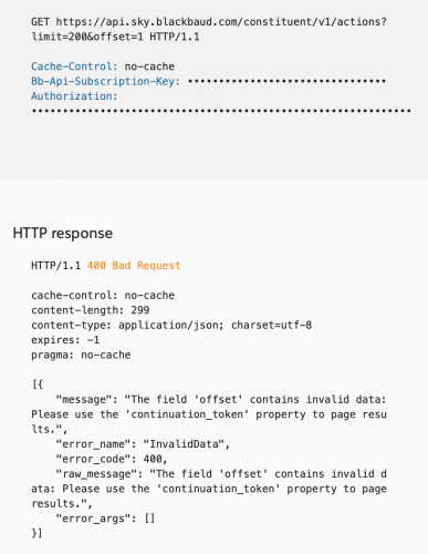

@Alex Wong thank you will give it a try shortly! Did you happen to run into any issues with the use of ‘offset=xx’ in your query? I'm just baffled that the offset works for other API calls but is consistently failing for Actions (All Constituents)
@Seth Ellis
I tried offset, and it is also failing for me.for a error message with 400 error code, I don't think it make sense. If Blackbaud does not intent for offset to be used, it might just be better that the documentation is updated to say offset is not supposed to be used.

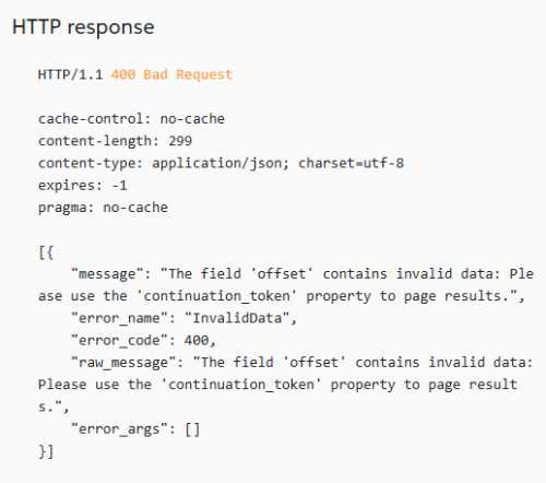

@Alex Wong I just tried this with the SKY API Console and see the same error. I'm checking with the RENXT team to see if anything changed. Thanks for bringing this to our attention.
