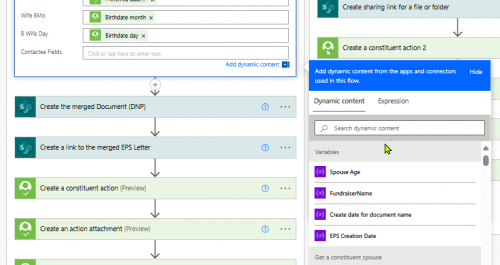

What could cause a Variable to NOT appear on a dynamic content list in Power Automate?
Not sure if I missed something or flow placement - this is what I have, but the Variable doesn't appear as an output option:

variable doesn't appear as an output option where?Some variable doesn't show in dynamic content due to the variable's data type not what flow think you should put at certain input field. So the question is what action input you are trying to access the array variable for what reason?
@Alex Wong I am looking to include specific custom fields to a word merge document in the flow - odd that I was able to do this in a previous document and the steps of the flow look the same.

@Alex Wong I believe the output will work -as I said, I patterned this after a flow that also displays multiple Custom Fields in a Word doc. But still not sure why the Variable doesn't appear on the Dynamic content list.

dynamic content not showing up is as I mention, data type.to “avoid” this issue, use a “Compose” action and put the variable in the compose, then Ctrl-A to select the variable, Ctrl-C to copy it. Then go to your word doc populate action and Ctrl-V to paste it.
or, you can go to Expression and type this in: variables('Name of Variable')
