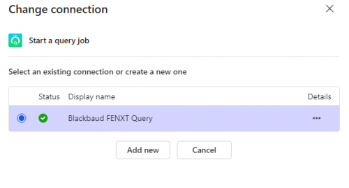

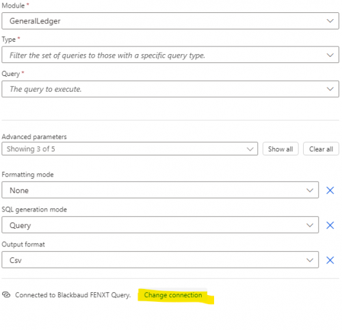

I switched to another environment in PA and started a new query action. Found the “change connection”By clicking it, it allows me to add a new one,

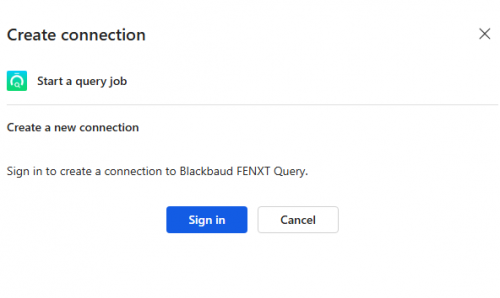

By clicking “Add new” and “Sign in” , no options in the following pop-up page.
I was under Developer's environment, rather than the Default one. That's the only two environments I have based on the license type.

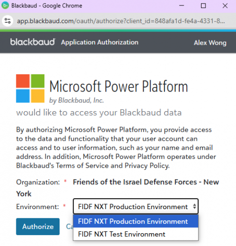

When I try to create new connection in power automate, I get:Giving me selection of environment to select.
My login is organization admin for both environment. Maybe check your access?
