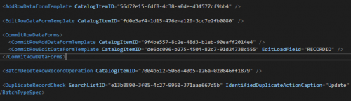

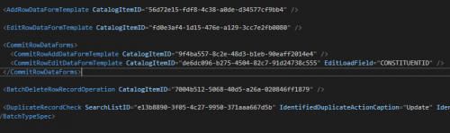

So after doing some experimentation it seems that the issue might be due to me using CONSTITUENTID as the EditLoadField in my BatchTypeSpec, as when I went and replaced that with a new field I was getting the expected behavior. I'm not sure if this is the true cause or not but it at least fixes my issue. I changed this:
to this:
