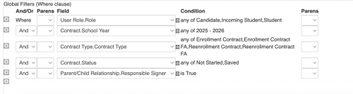

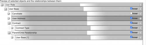

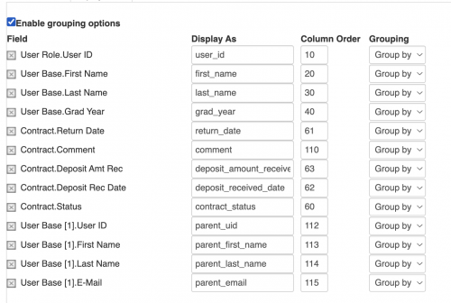

@Richard Pan you can create an advanced list to pull students with a contract status of none or started and their parent information, which you can use to set up a distribution group. Here is an example list setup (none of the contract fields need to be displayed for the purposes of the distribution group, I just add them to use for reporting):
Once you have the list set up and add it to the distribution group, you would just specify that the recipient is User Base [1].

@Troy Burki @Richard Pan We usually create an Advanced List exactly how Troy laid out here. Great post Troy. Once your list is all set then you can do a Pushpage and point the Distribution List to your Adv. List.
