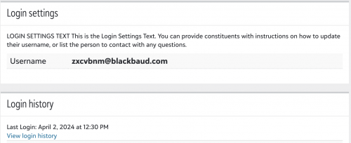

- Ask what they typed in the box there – it must match the BBID username on the Access tab. (Verify they actually typed it in from your login page and didn't just click continue. The trick is to get them to pay attention to this detail.)
- What do they see next after the portal login page? (does the email on that BBID page still match the BBID username?)
