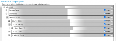

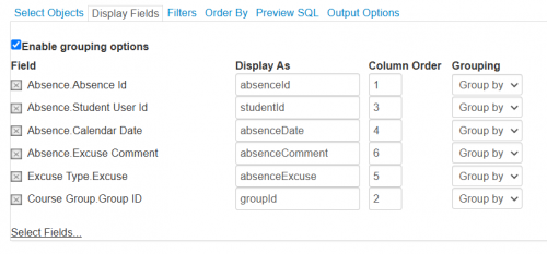

I built an export in Advanced Reports for our Student Success office so they could see all attendance by all students. I am including a couple screenshots of the basic setup of the report. Hopefully you or someone there can use this to develop a similar report. Note that in the field selection section you need to Enable grouping options in order to not get multiple entries for each absence.0
