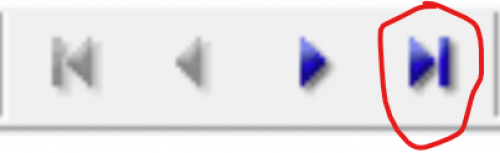

You can also try to click on the “last record” button, which will take you to the last record.
