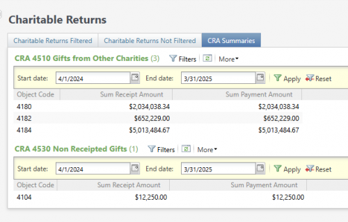

Is it possible for multiple datalists in a section in BBECRM to share the same parameters?
If there a 4 datalists in a section, is it possible to have the 4 datalists share parameters instead of having each datalist have their own parameter?

Hi Dan, Thanks so much for your reply. I would like to be able to enter the date parameters once instead of for each datalist. Would be able to provide an example?0
