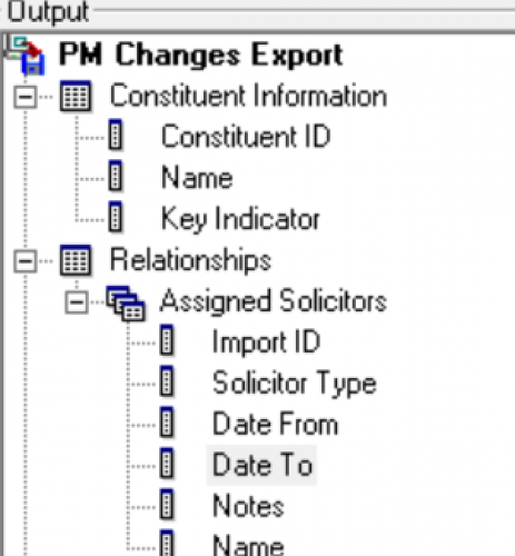

@Bryan Alfaro
Attached is a sample file I use to do just this. If you are just “downgrading” you actually do not need the ASRLink or Solicitor link that @Christine Robertson mentioned. I am also including a screen shot of the export I use to get the ids out that are needed for this process. Just add your end date and updated solicitor type and you should be good to go.Solicitor Update Import Sample.csv

@Christine Robertson Thank you!! We decided there was no need to change the solicitor type. But changing the Solicitor to Inactive was very helpful.
@Bryan Alfaro You're welcome - glad to help!
