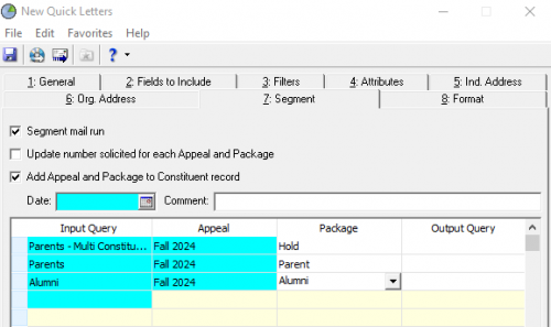

When we use the segmentation, we can opt to assign the Appeal/Package so that we can group those Parents separately and then not mail to them. If you add the Appeals/Packages, you can then remove the ones for the “Package” that you don't want to mail to (in my example, I called it the “Hold” package).
Make sure that you sort your groups with intentionality - I put the “Hold” group at the top because a constituent can only fall into one segment and I don't want Parents who share an address to fall in any other group.

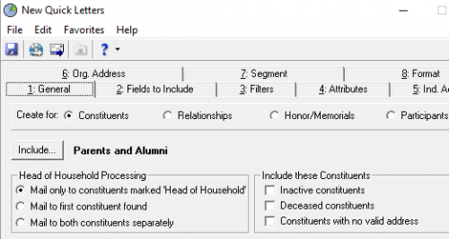

Here's are a couple of screenshots of what that Quick Letters/segmentation could look like:
