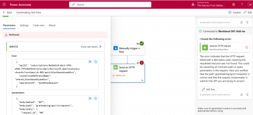

Hi. Is it possible to connect Grantmaking to Power automate via the SKY Add-in SendHttpREquest?
I have used this to build a flow with Raiser Edge Query API but have tried with using the Grantmaking API and just get a 404 no resource found error when I try to make a call. I have mimicked the call on the SKY Developer endpoint test so the actual resource is there and can be calle d by the API.

@Glen Hutson the one I am testing is Get Requests endpoint. I have tested on the sky api tester, postman and on my own web app and can connect fine. However in power automate I get a 404 response. The request ID is valid.

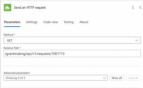

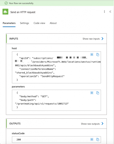

I did a quick double check and was able to call the endpoint via the Send an HTTP Request Action. In looking at your screenshot, I note two items: 1) You need to have an initial “/” at the beginning of the Relative Path parameter and 2) The Request ID is part of the Relative Path and not a Separate Query Parameter.
@Glen Hutson Thank you. It was the parameter bit that was what I needed. I had played around with the leading / already. New it had to be something reasonably simple. Thanks again for the second pair of eyes !
