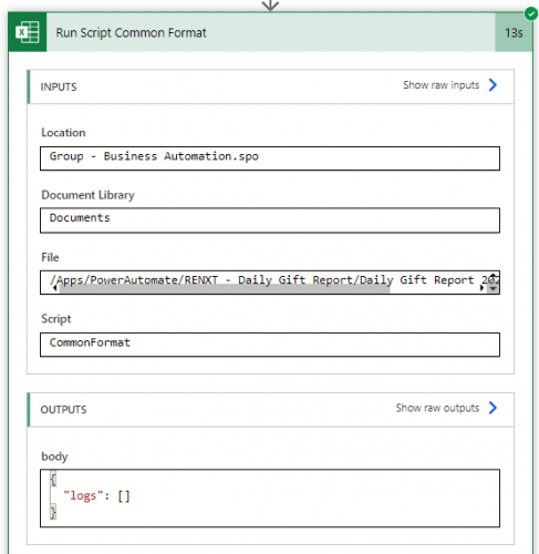

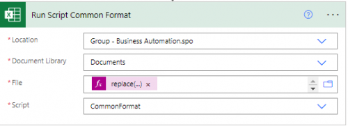

I used to use Excel Script a lot in PA when I was combining excel csv data from SFTP download into one report. They run without issue. I don't SFTP anymore (Query API replaced that), but do still use excel script for “formatting”. I have a “commonformat” script that format the excel as table and “proper” auto-width the table, and they are running without issue also. That said, what I mean to say is running excel script from PA is working, not a system-wide MS issue. That is always important to make sure first.So to diagnose this, you will first have to determine if your script got “called” or not. You can use “console.log()” to return a log message to the calling PA flow. You can add this as the first line of script and subsequently other places after some operation is done.
