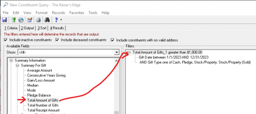

DB view > Constituent Query:- Criteria
- location (preferred address's city = San Francisco and state = CA)
- Summary of Gift Amount greater than 1000
- when selected, you get to select “sub criteria”
- gift date = date range you want to work on (no date = lifetime giving)
- gift type = select type that make sense (pledge and pay-cash should not be selected at the same time as that will double count)

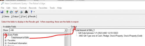

- output
- select what info youwant, then at the top where it say “Query Fields” you can select the total amount of gift
