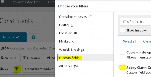

@Patti Posey, yes - you would enable another Filter, Custom Fields. Once enabled, you can click into the specific Custom Fields and set the value that you want.
Step 1: Enable Custom Field, and click Apply Changes

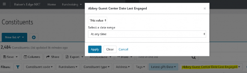

Step 2: Once it shows on the List Filters bar, click it open and select your criteria.

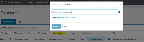

Another option is that you can create a separate list for people of that Attribute and then merge it out of the new LYBUNT list, using the Exclude option:0 -
