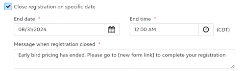

@Isabel Alcalde - I recommend you accomplish this with two registration forms. Set up your ‘Early Bird’ form with fees for that specific pricing; put an end-date on the form. Once the deadline passes, start utilizing the second registration form.
Example deadline and possible message. For how to organize the registration fees you have two options - create two sets, one for early bird pricing and one for regular pricing; one set with the amounts changed once the switch between forms happens. Personally, I prefer option 1 because you'll be able to easily sort on the registrants that came in during the Early Bird period.

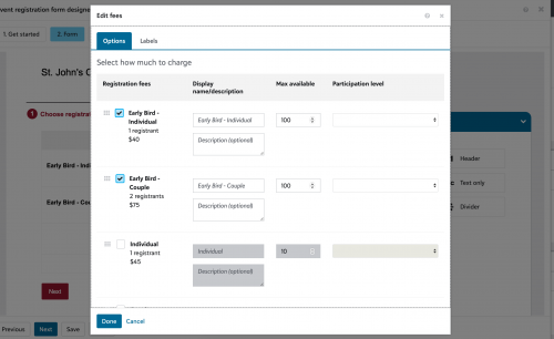

@Alex Wong Thank you, Alex! I noticed that you can add all the fees to the event, but when you are creating the form you are able to select which fees you want visible. If I went in and only selected the early bird fees and then edited the form later to switch to the regular fees, would that affect the link or the other registrations?
@Isabel Alcalde
As long as same form.. it is same link. Modified ticket level on form doesn't change link1 -
@Alex Wong Excellent! I am going to test run that since I think it will be easiest to have one form and set a date to go in and edit the visible fees. Thank you!
