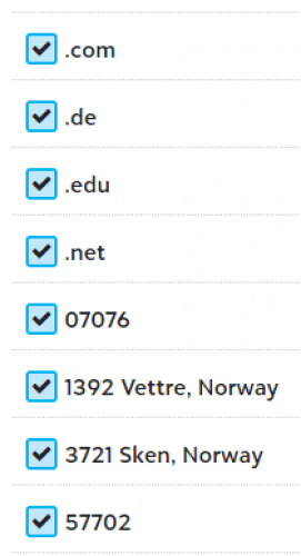

Any suggestions on cleaning up city field. It it not a table for our org.
In web view I can see multiple erroneous entries/spellings. When I filter on just that city name results are null. Country is required so I had selected US. You can't select more than one. Perhaps they are on a record with a different country. Don't have time to go through every country!!
So, I go to db and run a query Addresses > All addresses, city = one of the misspelled cities. Results are null.
Opened a case with support, one reply so far that didn't catch I said it's not a table field. Waiting to hear more.

That works for misspellings of “Rapid City”, thanks. Have done that type of clean up.
I have a very strange collection of entries for city name that pull zero when queried. Have to assume they are on a relationship somewhere.1 -

@JoAnn Strommen Several of those look like zip codes. Is the City somehow in another field?
If you run Address Finder or Address Accelerator, I wonder if that could update the Cities for you.
@Christine Robertson Yes, couple are definitely zip codes. But they are not on a constituent record in city field. I have not taken time to search participants and relationship records. Just very surprised to see them in web view city list.
We run AddressFinder every 3 months. Apparently it's not finding/correcting.

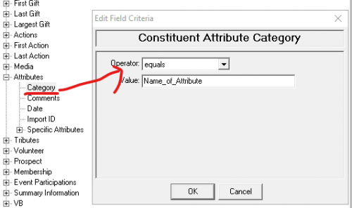

I have this giant export running this afternoon so while it's generating I'm doing some attribute clean up. Found an old attribute on a few records. Moved data to correct attribute and deleted old attribute from those records.
My query: attribute description, date or comment are not blank pulls zero records. Go to config to delete attribute and get message that can't delete as present on record(s).
Added spouse attribute blank to query. Pulls zero.
Not an attribute option on individual relationships.So where is this attribute on a record???? Yes, I'm the admin so no records should be hidden from me and all the boxes are checked at top of Q criteria tab.
So will try global delete of the attribute but being I don't have a query to work from it will run on entire db and take some time to process.

try Attributes > Category equals Name_of_Attribute0 -

AGH! Now citrix connection interrupted. I think I should go home!I would instead choose Specific Attribute Import ID not blank, and Spouse Specific Attribute Import ID not blank for that attribute. Because people could still have an attribute without having a date, description, or comment! Attributes are not fun, as they hide on you.
I have a very strange collection of entries for city name that pull zero when queried. Have to assume they are on a relationship somewhere.JoAnn,

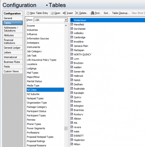

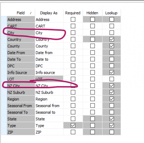

Are you sure you haven't accidently had the City Table be used? There are two fields for City, NX City (which is table based) and City.
Oh gross…by looking at that table I can see someone at some point chose NZCity as the city field and mine is now full of junk too!!!!
I have a feeling that this maybe the case for you, in which case you'll need to manage those in the Table section.

@Amy Barker No City is not a table. Was a previous org so I understand the difference. NZ cities is a table and the entries are not in that table.
