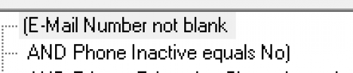

    @Ryan Moore I think this might pull what you want. I ran it for one year of alum and getting only active but looks like it pulled more records than there should be for one year.
    0685e6e93d11270b21a4cb27c5cf8511-huge-im
    'Phone' is a one-to-many field so results often not exactly what desired. I don't always find Query the best option. To be sure I'm getting what I want I usually take query to Export function.

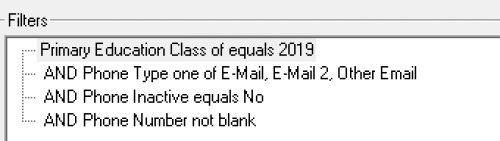

    You will not get dup rows this way:
    1019fabe19c1660b4eda4fa697a727fd-huge-im
    JoAnn, you get drup rows b/c of one-many relationship that has been “crossed”

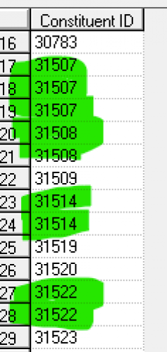

    That criteria may work for you but I get duplicates. (Put in class of so didn't have to pull entire db)
    ad849550ea445cc8af648c3b64d5ca35-huge-im
    99a9f15ba62b2f32ff5e9565fafb40e2-huge-im
    Record 31507 has 3 emails, one marked as primary. All active.
    Yes, I know that dups are because it's a one-to-many field. That's why I commented that I prefer to pull phone/email data using Export.
