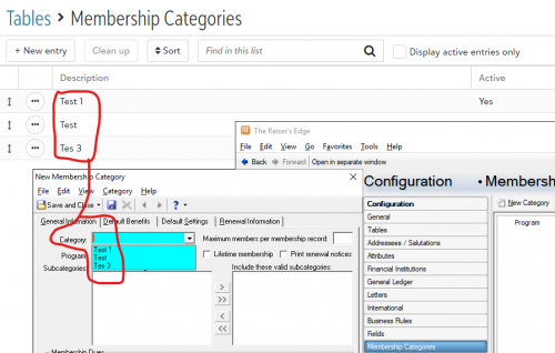

I think you have a misunderstanding here on the “table of membership category”, and to be honest, yet anther disappointing display of lack of knowledge in BB support rep. @Erik Leaver not sure if this is something that can be reflected up-ward to support manager.The table of “Membership Categories” is a list of selectable values in the drop down for creating a New Membership Category, inside RE > Configuration > Membership Categories. It is NOT the same as creating a new membership for a constituent and selecting a Category.
“Poor naming” but, you can think of the table > Membership Categories is category OF membership categories.
That said, after you enter the new entry in web view > Table > Membership Categories, go into database view (immeidately is OK), and go to Config > Membership Categories, and either open an existing membership categories or create a new one, and in the Category field, you will see the list of value in the drop down.
@Alex Wong Yes, it is was the Config>Membership Categories. My Programs were already set up, I just needed to set this other piece up. Thank you Alex!
