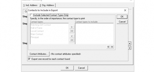

@Rashida Brown Make sure you have checked “export one record for each contact found”.
@Marie Stark I have. It's a strange issue. It works perfect for some organizations and contacts but not all. ?

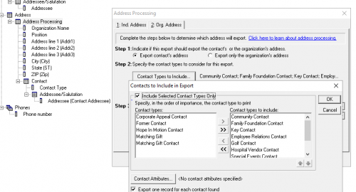

@Faith Murray This is an export. I am using Address Processing and specifying the contact types. The issue I am having is that the data being exported per Organization is functioning differently. One organization has two of the same contact type, however only one appears in the export. Another organization has 9 contacts, all relevant types are selected, yet only 8 are exported. I am using Address Processing because I need one row per contact. I believe this may be a bug…
@Faith Murray here is a screenshot of what I have in Export using Address Processing. Again it works, just not consistently.
@Rashida Brown
Yes, I see where you are looking now. In that case, my first thought would be to look for variations in the Contact address records themselves. For example,- do the missing Contacts have an email address but no physical address? Under Address Processing, it may filter out contacts with no address or it may defer to the Organization address, which may not contain your contact email.
- Is the Contact's address marked “Send Mail” and “Primary”? Both buttons must be checked in order to pull in Address Processing.
If all of this checks out, then I would contact Support. I've recently had some bugs with Event participant attribute formatting and have had an open ticket for 5 weeks. So, bugs do happen!
@Faith Murray that's my next step. I've spent a considerable amount of time testing and researching. The records all share the same characteristics so I do unfortunately believe it's a bug. Thanks for helping me think it through. I exhausted my own knowledge and wanted to see if I could find a miracle here in the Community before opening a case. Off to Support I go!

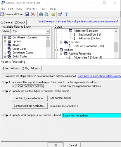

Where is that check? Or are you referring to the Number of contact types to export?0 -
Hi Rashida,
Are you sending to the contact's address or the organization address? If contact address, make sure the send mail is check otherwise they wont show up. This is how I have mine set up and have no issue dropping contacts.
