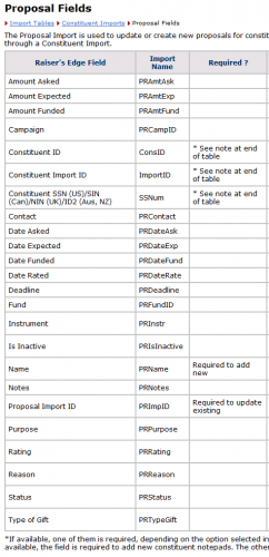

I am trying to import new proposals to our constituents. The process is not going through because it is asking for the Proposal Import ID. If I am importing new proposals, how can I provide the import ID? I though that is only required to update existing ones.

Yes Proposal IMport ID is only needed if you are updating existing proposal (as identifier for which proposal to update).. If you are creating new proposal records, you will need the Constituent ID or Constituent Import ID, and Proposal Name1 -

Thank you so much, Alex. Your response reinforced what I thought, which made me look into some other things. I found out the import process was not going through because I included the solicitor (to be able to import the solicitor, I needed the Proposal Import ID). So what I did was import the new proposal first (that created the Proposal Import ID). Then made a second import run for the solicitor (with ImportID, Proposal Import ID, Solicitor Import ID).Thank you!
@Bernard Nemis when you are adding new proposals, you can assign your own proposal import ID's, so you don't have to create a 2nd export/import file for solicitors. Import round one exclude solicitor, import round two update to add solicitor
