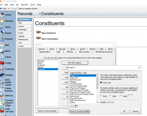

@Alicia Valtierra How the gifts show on the gift tab is determined by the legend settings. Right click while on the gift window (or can be done in user settings). Find Soft Credit in the gift type window. Select your font color, bold/italic and put in your suffix of -SC.

Exactly what @Strommen said. Here's a picture so you can find the Legend settings. It's unique to each user.5 -
@Faith Murray Ah, this is EXACTLY what I needed. Thank you!
@JoAnn Strommen glorious. Thank you so very much! This makes perfect sense. Seems like it was set up before I had started with the company 3 years ago.
