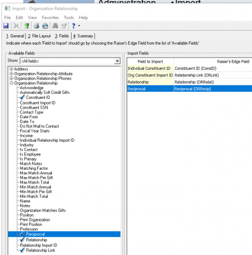

Yes you can do an import, but you will need the org's constituent import id instead of the constituent id to do the linking3 -
@Becky Perkins As @Alex Wong mentioned, you do need the Constituent Import ID of the Organization for this rather than the Constituent ID. I would also use the Constituent Import ID for the record that is being related to the Org. I've found that sometimes using a combination of Import ID and Constituent ID just doesn't play nicely in RE Import.

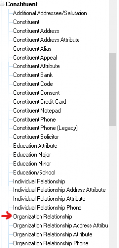

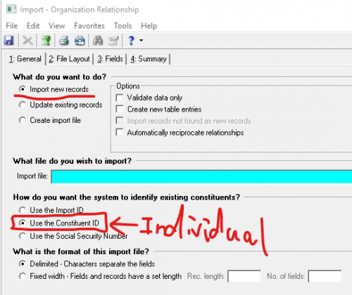

I have always used Constituent ID for the individual, and then Constituent Import ID for the Org record to relate to and have no issue importing. It is important to make sure the correct option is selected though.As for your comment about creating your own Import ID for the relationship, I think there's goods and bads of doing so, I like to keep import id the way RE auto creates them, which is always, 00001-xxx-0000000000 where xxx is the unique to the “type of record” (gift, constituent, participant, etc) and 0000000000 is actually the system record id of that record (i.e. 0000000001, 0000000002, etc).
NOTE that the Org Constituet Import ID is map to Relationship Link
