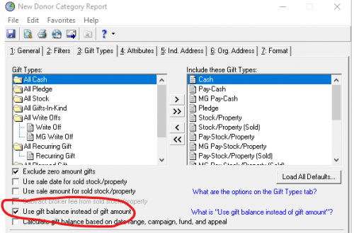

@Naila Asif Are you using the check box for pledge balance rather than pledge amount? If you do that plus the payments, I think that would work for what you're describing.
@Christine Robertson, No I know about this option, I am just pulling the commitments plus one time gifts, not including any pledge payments. The problem is that it gives the original pledge amount and not takes care of the write off, so donor is showing at a certain category but actually he belongs to a lower category. I have asked BB customer services and there is no solution, unless I run the write off report, them manually subtract the write off amount and then move the donor to correct category. It's a lot of manual work. What's the benefit of this report for my organization?

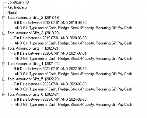

Use a donor query, and use Summary of Giving, then select the gift date (the year you doing donor category) and gift type that is consider committed revenue (i.e. Cash, Pledge, Stock, etc, do not select pay-*** or write off). Summary of Giving will automatically remove write off from the pledged amount as part of it's calculation. Then in excel, you will have to do donor category using excel formula or pivot

Using the Donor Query > Summary of Giving you will get John Smith $50K in 2021 and $70K in 2022 column for you to do excel formula or pivot table on to get the donor category.
and in output just need Constituent ID and the Total Amount of Gifts_1 from the Query Fields section, you can do that for each year you are doing donor category.
or if you want 1 query file .. you can do multiple of Total Amount of Gifts one for each year and use the OR operator in Criteria tab, then output each year's giving with the Constituent ID, and then work in excel that way.

@Alex Wong, I just see this comment, so you are using a constituent query. I will try to do it this way and see what I get.
@Alex Wong, thank you so much for your help, I am getting the correct amounts in the query and it is deducting the write off amounts. I will manage to identify the soft credit issue and then create the pivot for categories in each fiscal year.
Constituent ID Key Indicator Name 2018-19 2019-20 2020-21 2021-22 2022-23 2023-24 17514 Individual Donor A $0.00 $0.00 $50,000.00 $0.00 $0.00 $0.00
