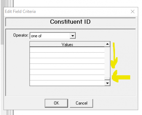

@Ryan Moore You can do Option 2 of Christine IF you do not have 1000's of Constituent ID since you can can Copy the ID from Excel by doing click Ctrl C after highlighting the ID's in the spreadsheet, going to the query and doing “of of” and moving to the last row of the
The clicking Ctrl V and you will see the ID's once you move back to the top of that. But as I said this only works for a set number of 500.
Save that query and attach it to the Global Add.

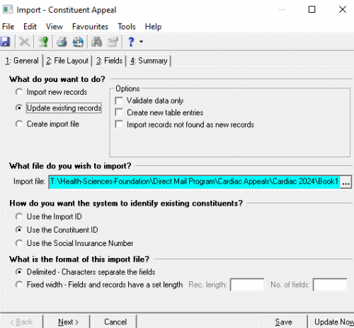

Going into the Constituent Appeal import

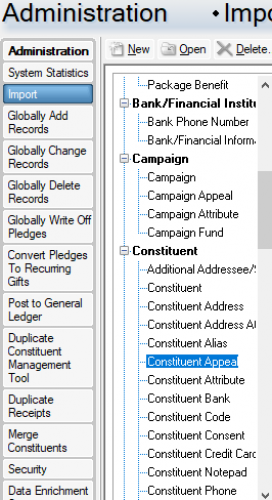

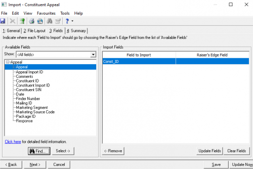

I can see where to import the file (I extracted just the Constituent IDs of our list), now where in the import procedure do i ‘connect’ those IDs with CARDIAC2024?

As I mention, you need the csv file to have 2 columns: Constituent ID and the Appeal ID.First issue, you are not “Updating existing records”. You are doing a “Constituent Appeal” import, which is importing constituent appeal record, you are not updating constituent record. Select option to “Import new records”
It looks like you only have 1 column (Const_ID) only. you need the 2nd column filled with the Appeal ID you want to add.
Const_ID Appeal ID 111111 CARDIAC2024 222222 CARDIAC2024 When mapping, you will map Const_ID to Constituent ID and the appeal column to Appeal.
