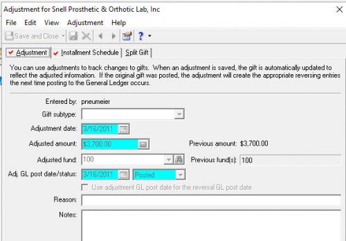

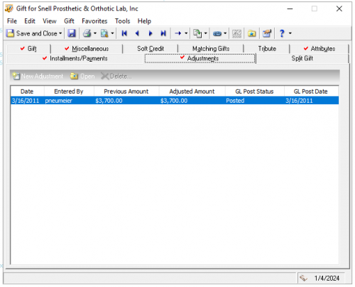

I have pledges that are not coming up when trying to run a Total Gifts query. The only thing I see is that the pledges have adjustments on them. Interesting enough, NXT shows the correct total giving but not in RE. It appears the adjustments were made to change which fund the gift went too.
What can I do to make these adjusted pledges appear on the total gift query?
@Holly Tindall

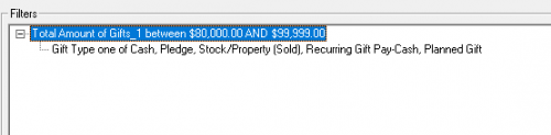

Can you share an image of your query criteria as well as an anonymized image of one of the problematic pledge records? That would help us provide feedback. Hope we can help!1 -
@Holly Tindall Since you mentioned a Total Gift Query, I'm assuming that you are using a Constituent Query with a Summary field for total gifts. Can you post a screen shot of your Criteria Tab as well as screenshots of what settings you have on the Summary field? It's likely that a setting in one of those two places is the culprit.

The gift was given in 2009 and this adjustment was done in 2011.0 -
@Holly Tindall
adjustment on the pledge doesn't affect summary of gift in constituent querywas the pledge written off? a written off pledge will affect
@Holly Tindall What is the criteria (the first tab) on the query?

I think the criteria tab was sent as screenshot already.@Holly Tindall your criteria is looking for lifetime giving (based on the gift tyep you selected) that is between $80K to $99,999. and you are saying that the constituent in question is showing up in the output with $3700 less in the total giving output? or are you saying the constituent is not showing up at all?
if exactly $3700 less, and this gift you screenshot is not written off, check other pledge to see if there is a total of $3700 written off in all pledges by this constituent.

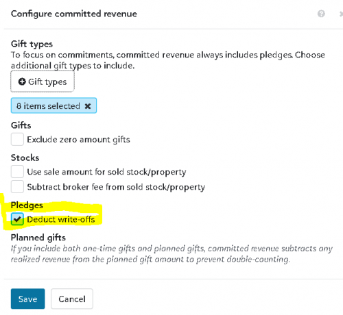

Jumping off from @Alex Wong's advice, you need to go to your NXT Settings, under Giving Analysis, both Committed Revenue and Recognition, and make sure that this button is checkmarked below. Amounts between NXT and DB view may still configure differently from time to time, but this should help with the current error.3 -
@Faith Murray @Alex Wong @Christine Robertson
Thank you all for your help. I guess it's just an bug in NXT as that is checked already.
