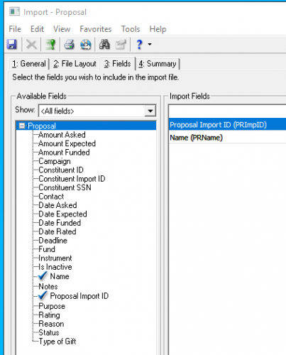

There is a proposal import that you can get individual proposal per line with proposal import id3 -
@Alex Wong thanks for confirming, I thought there was something like that but couldn't remember. I guess it has the same issue as Export in that it's difficult to specify the exact proposals you want, but at least they come out one per row, rather than one row per constituent with their proposals across multiple columns.
@Alan French
not sure if I understood your reply, but want to clarify anyway.Export: 1 constitent per row, and you will have to ask for how many proposal to export, knowing the max per constituent to do.
Import to create an export file (using the proposal import): 1 proposal per row, constituent having mulitple proposal will have multiple rows with individual import id for each proposal on each row
