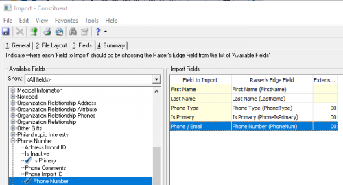

I am working on an import of new constituents and was wondering if there was a table entry to indicate a phone as primary?

a phone is primary or not is not a table entry, it is a “checkbox” (yes/no).for importing, you just need to have a column of yes/no to indicate if the phone is primary and then map to the “is primary” field in a constituent phone import

Is the field column header “PhoneIsPrimary”? I couldn't confirm in the Import Tables documentation.0 -

I don't remember. However, the import file header does not HAVE to match what the import “expects”. If you have it that way, great, it automap the column for you, but if not, you can just manually map the column to the field in the 3rd tab of the import window.2 -
@Alex Wong Could you demonstrated with an example?
