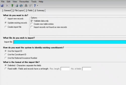

I am a little unsure about how to populate this form below. How could I do a test import and see if that does what I need it to do?

Create your import file as a csv and select it, then go to Fields to map each one. If you are going to use the import again then you can use the field mapping to name the column correctly so mapping is not required next time. Do small test imports and always validate first but once you get the hang of it you will find it quite easy.
I still sometimes get the Importing new / updating wrong if I don't pay attention as it depends on the import type. For example, if you use a Gift import and are adding an attribute you are updating (the gift) but if you use a Gift Attribute import and are adding new attributes then you are Importing new (attribute) records.
From the Raiser's Edge Fields you can right click and select Legend then colour code Required Fields / Conditionally Required Fields and Non-essential Fields which I find helps.

Using the “validate data only” checkbox and running it will let you know if you will encounter any errors. You should be okay using the gift import ID and the missing field. If you have the gift import ID, you shouldn't need the Gift ID. You can also create a new file with 5 or so records and try it. Not sure which field is missing so I can't get into more specifics. This should be an easy fix.1 -

As importing is a powerful tool, it is also a dangerous tool. I strongly recommend you take some import class from Blackbaud, even if it's only the online self learn stuff.That said, every import varies, and will require you to do mapping correctly.,
For example, if you are trying to change gift info that's 1-to-1 on a gift record, such as gift date, gift amount, reference, receipt, etc, you can do a Gift Import, and use the update existing record. You will need the gift import id of the gift you want to change.
If you are updating an existing gift attribute, use the gift attribute import, you will need the gift import id AND the gift attribute import id that specific target the gift attribute of the gift you are trying to change.
If your gift is missing gift attribute, you can the gift attribute import, but use the “import new record” selection, for this, you only need gift import id, as you are creating NEW gift attribute, not updating an existing gift attribute, you won't need/have the gift attribute import id.
