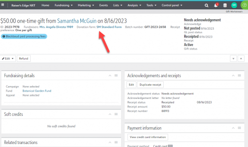

There's no way to see which form a donation originated from in gift batch today. Once you approve gifts, in the NXT gift record, you will see the Donation Form name there (screenshot below.)Can you tell me a little bit more about what you'd use the donation form name for in gift batch?
