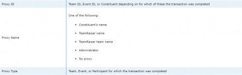

I figured out that I needed to use the TeamRaiser > Add Gift API but I'm still confused on what the PROXY_TYPE and the mfc_pref are…
@Neil Shweky MFC is not used in the API. "MultiFormatComponent" - so that's the "mfc" portion of it - and the code indicates it's a URL parameter that says whether or not the link should refresh the parent page, when it has been opened in a popup window.
proxy_type - Give the type name (participant / event / team) or the ID (20 / 21 / 22
