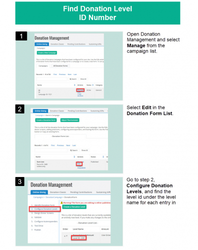

I'm trying to make a Luminate Online API integration, and I'm not exactly sure what the level_id parameter on the addOfflineDonation request is. I know that it has something to do with the amount of the donation, but I don't know what the ID represents. How can I just input an exact value for the donation?

Thank you so much for bringing this to our attention. I think this page needs to be updated. I am going to reach out to our Luminate Online team and make some updates to this page. I will try to get you an answer and update the page ASAP.1 -
@Neil Shweky
Good morning! I have some information for you. I hope this helps.0
