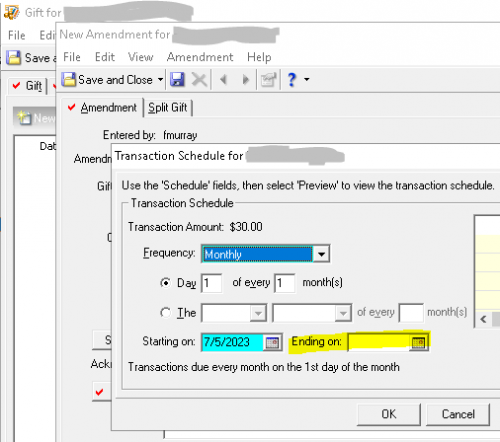

@Marta Hutchins, this is shooting in the dark a bit, but would it help if you erase some of the data in the Terminated gift, such as unchecking the “EFT” box and deleting the card processing info? Or, do an Amendment for the Terminated gift and add an “end date” to the schedule so that the system does not show it as having any future transactions due?
Not sure if these will help, but worth a try!

@Faith Murray so I kind of used this approach to finally get the schedules back on track. Thank you!! I made an amendment with the correct date for the next expected payment, and then went into the Transactions tab and rolled back transactions until it was aligned with the correct date for the next payment. No clue if RE representatives would recommend this… but so far so good. Thanks, Faith!
