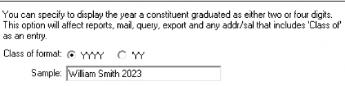

@Michaela Walker Yes - you CAN configure this!
Go to Config | Business Rules | Alumni Options, and change the setting to a two-year format:
If you enter a class year as 2005, it will display as '05 in any addressee format that you have created that includes “Class of”.
I think that's what you're trying to do?

That makes sense. In configuration, if you change it to display 4 year digits, that's how the addressee formula will look. If you change it to display 2-year digits, the formulas will work just fine and display what you want.
