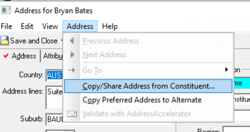

@James Rhodes
Yes, there can be duplicate addresses. I am referring to ‘shared’ address. Say Bill Smith is a constituent. At some point a record is needed for his wife Sue. While a user can key in the same address on her record, a better practice is to ‘share’/link the address from Bill's record. This way when one changes, it will be changed on both records. Just a thought that it could affect your cleanup.0
