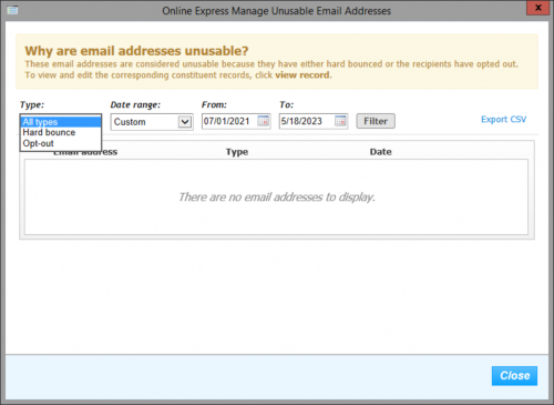

@Adam Stobart Have you accessed the Unusable emails when you are in OLX Marketing area? You probably have, however, if not, you will see a button named Unusable emails. Open it and set a date range (if you typically download appeal tags into RE records, make sure your range includes the last date the constituent received anything). You can download the list and search for that email. You can search for just bounces, just opt-outs or all. Hope this helps you out!
