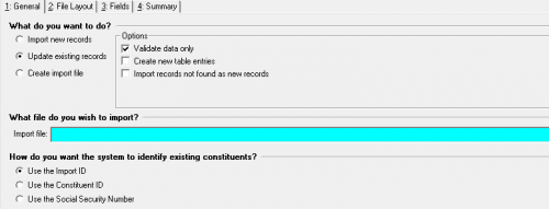

Here is the screenshot of the import settings. I used this same import type to create the import file. Since these are updates to existing phones, I wouldn't be able to create a data file for you, but you could create one using this import, and use that to test.

@Dariel Dixon, if you would like to send me some snips of your import settings and the first 3 lines of an anonymized data file, I can try to replicate on my system and help troubleshoot? I'm afraid imports are so touchy, I usually have to get my hands into them.
