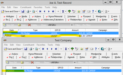

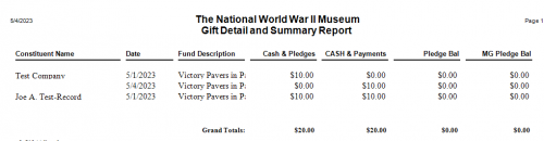

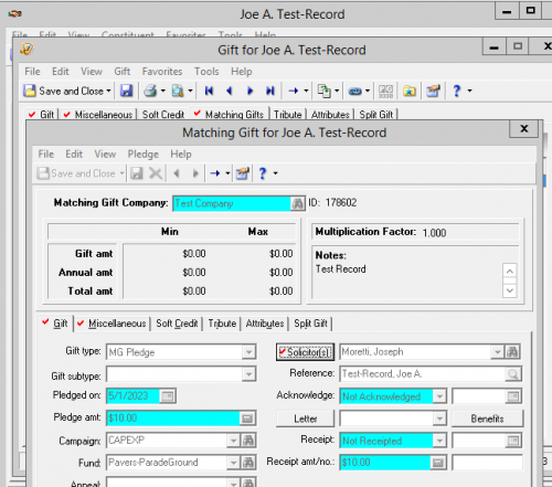

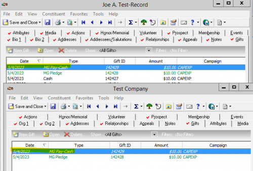

@Shelby Mills My opinion is that Matching gifts should not be soft credited, that is the whole purpose of the Matching Gift type and the Matching Gift pay cash type. When a person makes a gift that their Company will match, enter the cash gift and as long as the company record has the box for Match Gift checked, the MG Pledge will appear on the company record and populate the donor record as a Matching Gift for that company. Once the match comes in it is applied to the MG Pledge and then will appear as a MG Pay-cash on the records. Gift Detail reports will not double count as long as your criteria in the report has Credit Matching Gift to MG Company. I have found that soft crediting MG causes issues since it is not really a soft credit, especially orgs that do it both ways. But again MG money should not be soft credit and you should use the Matching Gift field.
