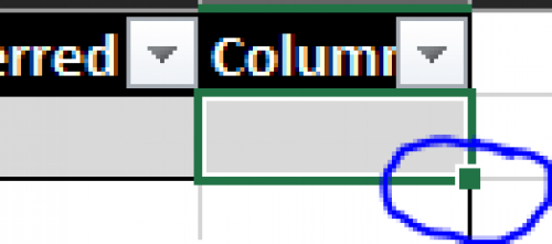

You can drop the formula down to all rows in the table by double-clicking the small box on the bottom-right of the cell:Depending on how many rows you have, this may take a while for Excel to create the formula for every row.

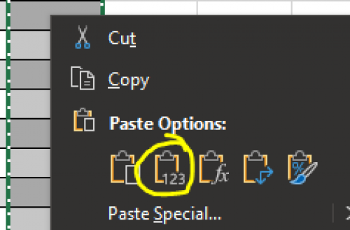

Because of this, after you've done this, select any cell on the column and hit CTRL+SPACE to select the entire column that contains the formula. Then hit CTRL+C to copy it, then right-click the column and paste the values of the selectionThis makes the spreadsheet not have to work as hard when you start sorting rows. Before it'd have to recalculate every formula each time you sort. Now it just contains the values “Duplicate row” or a blank → easy to sort.

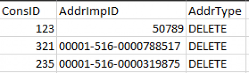

4.) Use the Import tool to “update” all of the dupe addresses with the “DELETE” address type
-Create a new spreadsheet and save it as a “.csv” file.-Copy/paste the columns for ID and Import ID from your address spreadsheet into this one.
-Rename the "ID" column header to “ConsID” and the “Import ID” header to “AddrImpID”
-Add a third header in column C called "AddrType"
-Fill all the cells in column C down to your last row in A/B with the new address type, such as “DELETE”
-Save the file
-Should look like this when you're done:

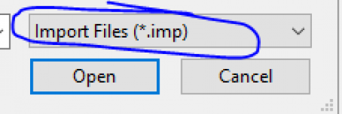

-Go into Admin → Import → Constituent → Constituent Address → create a new import-Select “Update existing records” + “Validate data only” (for now) → “Use the Constituent ID”, and use the file you just created as the Import file
-You'll need to change this to find your .csv file:
