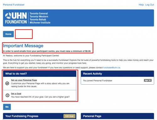

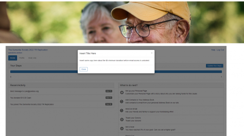

Here's our implementation in plain javascript (borrowing VERY heavily from the awesome Yeeboo/Jeremy R jquery version):Very similar functionality to that solution, but slightly different handling, in that instead of completely hiding the pc's email features when a participant hasn't met qualifications, it just grays out and disables those features – showing that they are available, just not enabled yet. Also, first time a non-qualifying participant logs in, it shows a large message about disabled email – on subsequent visits, there is a small, inconspicuous message instead of no message at all. When the participant meets requirement, the message disappears completely, of course.
