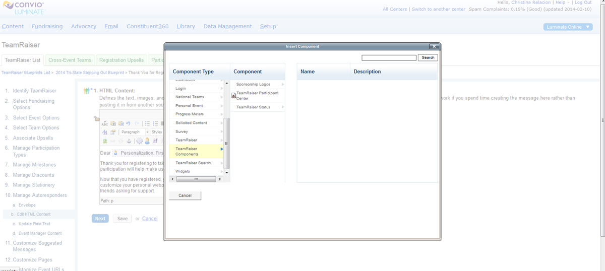

I'm configuring autoresponders for event participants and I'm having difficulty finding where to personalize the link to the participant center. I've found how to embed the participant center but can't seem to find where to just have it link to the person who is receiving the autoresponder. Is that possible even?

    Hi Kent,
    Thanks for the reply. I see three options when I edit the AR. The second one for the Participant Center actually embeds the PC into the email. I'm just looking to insert the URL...Am I missing some components to select from?
    You need to create a link and then use the link tool. So you can create a button or text, highlight it and then use the link tool. In the link config you'll choose TeamRaiser and then in step 2 of the link config it gives you options where the link is to go.
