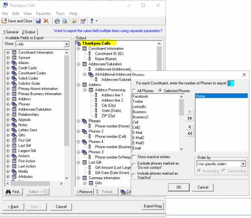

@Kevin Eccles, that is doable in Export! You just have to right-click the “Phones” and narrow your criteria to select one Phone Type per export line/column. To get multiple export columns, you just have to click on the header (in yellow) before clicking on “Phone Number” in the left sidebar again. Here's one of my phone exports:

Many blessings upon you and your house! It didn't occur to me that the GUI would have that much affect on the export query. I'm a terminal junkie and would be more comfy with a text editor and a place to run my SQL queries.
Thank you very much for your help there. I think I can work it out from here.0
