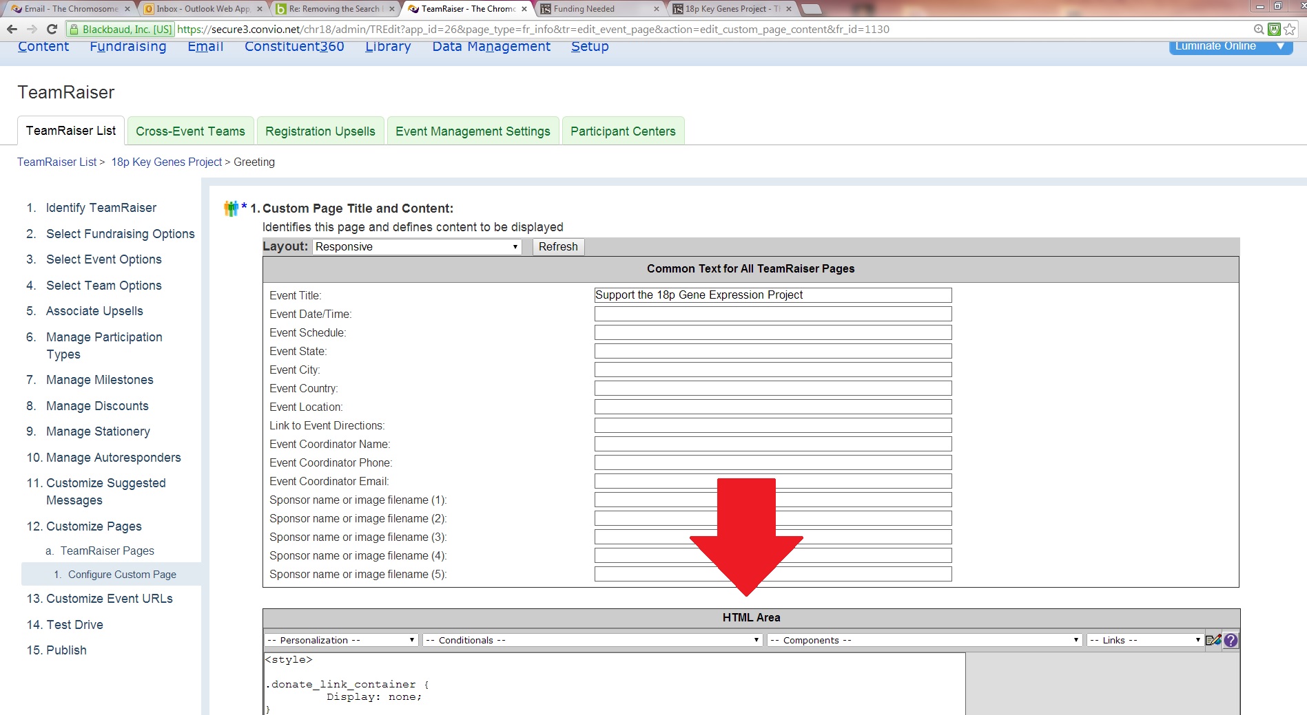

In the meantime, though, yes, the TR homepage is in the greeting page. I went into that editor and pasted the code you included, but no love. The "Search for a Participant Box" is still there. I am sure I'm doing something wrong.0 -

In the meantime, though, yes, the TR homepage is in the greeting page. I went into that editor and pasted the code you included, but no love. The "Search for a Participant Box" is still there. I am sure I'm doing something wrong.Try removing the period at the front of the CSS. I'm about done with my webinar stuff and can jump into your site to take a look if you'd like.

Ok. I figured out what the problem was. That's a default element that you can add with the responsive design layout. I went into your wrapper and created a new version and added this:
<style>
#donate_link_container {
display: none;
</style>That removed it. Please check around in your pages and make sure that didn't mess anything else up. It shouldn't have but I just want to make sure.
