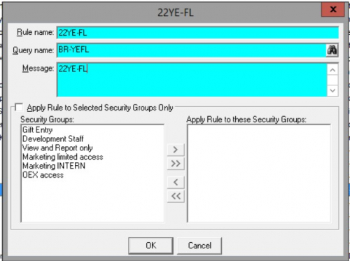

I agree with all of the above! I also like custom business rules. I have business rules for head of household so I can make sure the gift goes on the right record, outstanding opportunity/proposal so I can make sure to link the gift, thank you letter preferences, whether the donor has an assigned solicitor/fundraiser, and the most recent appeal with package code.

@Sunshine Reinken Watson Would you be willing to share your business rule for most recent appeal? That is my biggest time suck - opening a record to see the most recent appeal, and I can never get RE to keep the sort of most recent first.

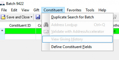

@Elizabeth Johnson Is that from the drop down menu, or is it something you can see in the constituent window?

Hi @Beth Halleck,
It is from a drop-down menu in the batch. From the Constituent drop-down in the batch when you are on a constituent View Giving History will be an option. Here is a screenshot.
Hope you will soon enjoy this feature too!

@Beth Halleck Yes, I have constituent queries for each package and a corresponding user defined gift business rule (Config-Business rules). It requires some maintenance but saves a lot of time in the long run! I always search for the constituent to catch any business rules like this for any OEX gift batches.
