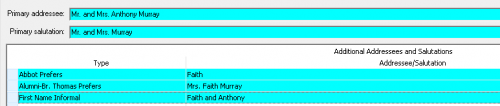

I'd base it off how most of your mail is formatted. If 90% of your mail is addressed to them as a couple, then make the Primary on your HOH formatted to the couple. You'd want a separate addressee formatted to the individual for those less frequent alumnus mailings.For example, here is my own record:

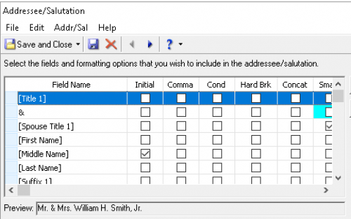

Here is how that formatting looks under Config. Note the checkmarks under “Initial” and “Smart”:
