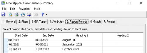

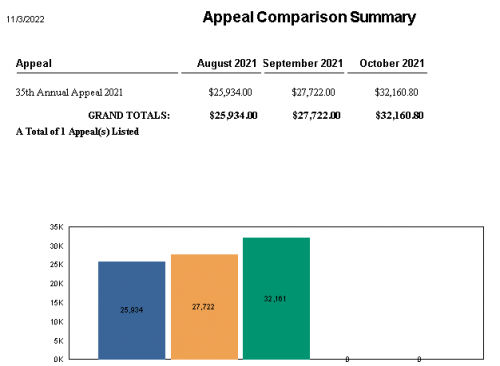

I think you can accomplish this in database view, under “Campaigns, Funds, and Appeals Reports” and use the “Appeal Comparison Summary”. You can set your report periods and you can run a single appeal or multiple appeals. A second report exists for Fund Comparison Summary, and another for Campaign Comparison Summary.I created a test report for a span of 3 months and this is what it looks like. Of course, you can adjust settings, filters, gift types, labels, etc. The only limitation is how many columns you can fit on the page in portrait mode.
